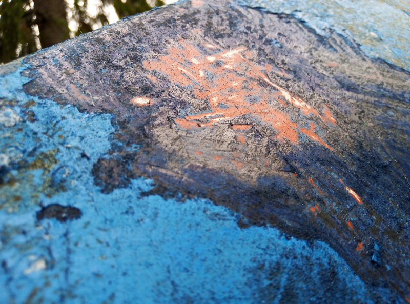

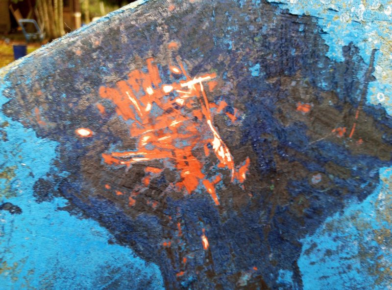

Oh! I brought home a rudder for the experiments 8) It have 6 layers of paint:
light-blue layer with soft mechanical consistence;
deep-blue layer - soft;
black layer - hard,
thin light-blue layer again, with undefined mechanical cosistence;
polygrund.
Maybe, it will be enough just to scrap off only 2 upper blue layers? Have you any ideas about the type of a hard black paint?

You will be laugh, but I find the best tool to fast and safe scraping upper layer... This is the most ordinary axe, used like a scraper. :lol:
5 minutes, and the rudder is ready to grinding. I found a couple of blisters under the paints, but I think, what this is not critical. Moreover - this is rudder, which always keeping wet, with water inside! I drilled the holes, recommended here.
In the end I think to leave the black paint as is, because it is very hard to grind off, and it staying very well on a grund. Also, I suggested to use an industrial vinyl-epoxy antifouling. But I still feeling doubts about barrier layer on a probable-wet laminate.
Yes, I have a lot of time - this is primary target for this winter to prepare the boat. By the way, I always thought, that in salt water polyester laminate lives much longer, than in fresh water.
And after tomorrow I'll go to the boat. With the axe :twisted:

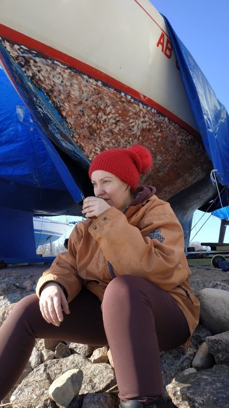

Spring is coming, and I started to grind. In 8 hours total, I grinded off a half of boat. Later I'll grind a right half, and will waiting about a month.
The technology of covering I see as follows:
When the constant positive temperatures will established, I will wait for a few Sunny days. Then I'll grounding IF's bottom with a pure epoxy. After about 12hrs, I'll overcoat first layer with mixture of epoxy and aerosil (tixotropic additve, which helpes to make more thick layer). Then, after another 12hrs I'll cover this with the most common and xx ground - for further layer of antifouling.
Sadly, I have no photos less than 800px.
https://pp.userapi.com/c850428/v8504288 ... SZ2UzE.jpg
https://pp.userapi.com/c855232/v8552328 ... j1l45A.jpg

Well done!
The forum software should scale down your images automativally if they are too big. Doesn't that work?
Re: To grind or not to grind?
Postat: 06 apr 2019 11:15
av if1038
Oh yes! It working!)))
My wife posing
By the way, my brother proposed me to cover the bottom with the polyurea. His firm is engaging in the application of such coatings. In the past I has such experience - I was coated my another boat with polyurea. However, in that time I failed my work, due to technology disruption. Now, the work would make a real specialist with industrial equipment. Hmmm... I thought hard.
