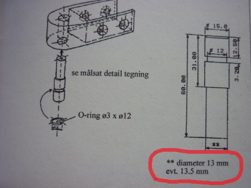

Hi there,
I've seen a lot of info about the screws and pins but didn't see a picture with the measures of the hings of the rudder.
I`m intending to make a 3d drawing of it.
There are not many drawings of details about the rudder except these;
Re: drawing hings
Postat: 28 feb 2022 09:50
The drawing displayed here is the only drawing of the kind that I have ever seen. It was published the first time in the Danish IF-boat magazine "IF-bladet" a couple of decades ago. The author was late Henrik Blomdahl, the former owner of "Muffe".

Okay,
Then I have to do it myself from the original
Thanks

Just made a few drawings from it

This original sketching are from Medvind nr 2- 2010.
L Å Andersson
Re: drawing hings
Postat: 25 okt 2022 21:29
You are quite right L-Å!
I just measured three old ones I have saved. The diameter is larger than 12,00 mm. It varies between 13,10 and 13,30 mm on those three, measured with a caliper.
Perhaps there are variants. Check for a press fit in the hinge part hole before making the pins!

I made the drawing by measuring old ones so there will probably be a difference in the sizes.
So be careful when you replace this part
