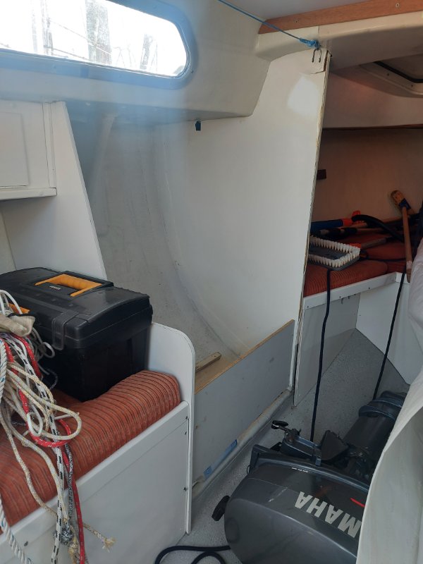

I have an adapted interior but know that a wardrobe must be present during competitions. I'm thinking of a panel that I put on during races, much like a picture shows.
Is this sufficient or should a side panel also be present.
I can also make a narrower panel with the same height but narrower.(Like the new IF)
The question then is whether a side panel is also needed.
I'd love to hear how it's done, vrgr Adri van de Velde

There has to be a wardrobe with a width of at least 350 mm. The wardrobe height must be at least to deck level and it must have a front with an opening or a door.
In my opinion your pictures show something that is not allowed. There is no front, the height isnt't enough and one side is missing. That is simply not a wardrobe.
Let's see what other users think!

There is a picture missing of a kind of additional panel (the old one as an example).
Maybe this one is something?
or has it to have a side panel as well at deck level?
Otherwise, I can make a smaller (350mm) front panel to deck level with a side panel to the hull.
And put the whole thing behind the lower front panel that already exists, just during races.
Is that an idea?

Also add a top cover to make it a complete wardrobe or, alernatively, make the vertical panels higher so they reach the inside of the Cabiin ceiling.

Okay, I think I get it.
I will make a small (35cm) front panel at deck level with an opening and a side panel to deck level included a cover.
So that will be (more or less) as in the new IF from seacamper.
First I will make it demountable but when it looks not bad I can consider making it permanently
Many thanks for your help
I will have my IF as light as possible but within the rules for races
Reg, Adri van de Velde Spotgaai NED1417

Next stage, on my way.
Better, right?

Looks nice. Do not forget the top cover .
(cannot be seen on the photo).

The result of some homework to make Spotgaai according the rules
