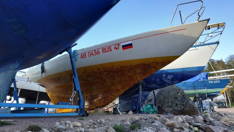

Re: To grind or not to grind?
It was difficult, but I done it! That is all for the bottom. Now I need a little holiday. CL2irMkH92I.jpg sn-FFTYhaUw.jpg I think, antifouling is not nessesary for cold waters, where I planning to sail this summer. There are grows only a bit of seagrass like a green snots, which are easily cleaned ...

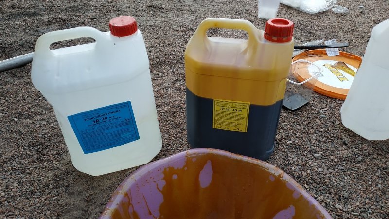

Oh yes! Just a 5kg of epoxy and a first layer is complete. And it didn't even need to mix any filler. The temperature was around +10C and the resin was quite viscous in its pure form. I'm tired to roll it out to surface.

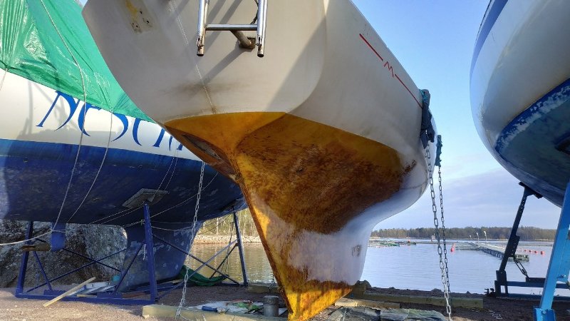

That looks good! I think it is clean enough for the epoxy painting. Those last old Polygrund primer rests wont have to be removed. Follow the instructions for the epoxi resin. Wait for some days with good weather, so that you can paint the layers with the proposed settling time between. If you wait ...
So, I grinded hull quickly for a few days and leaved to stay it naked during April. A dry and sunny weather is staying, and this qute perfect! Now is time to a final preparing for a painting :roll: Also, I want to lift a waterline for a few centimeters up. After a couple weeks I'll buy about 20kg of ...

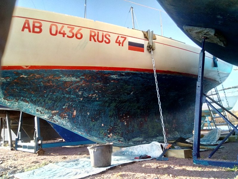

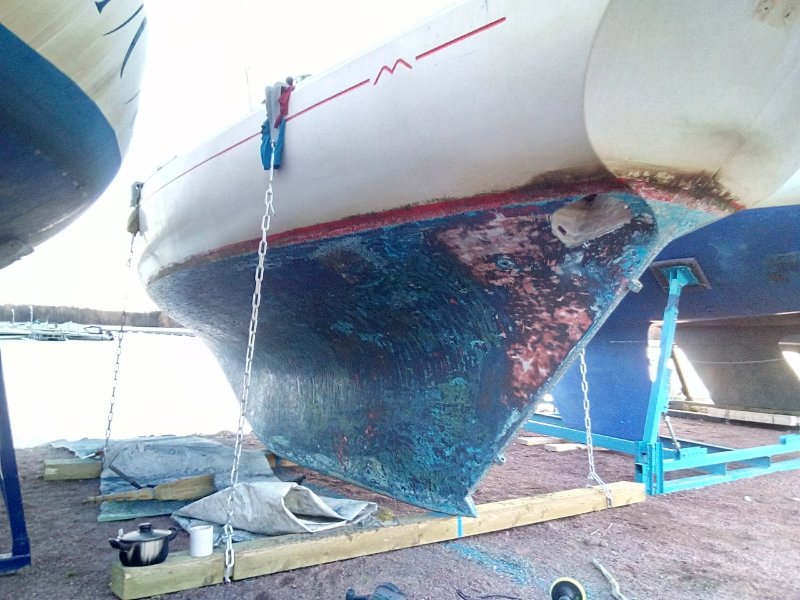

Hello again! :P Spring is coming, and I started to grind. In 8 hours total, I grinded off a half of boat. Later I'll grind a right half, and will waiting about a month. The technology of covering I see as follows: When the constant positive temperatures will established, I will wait for a few Sunny ...

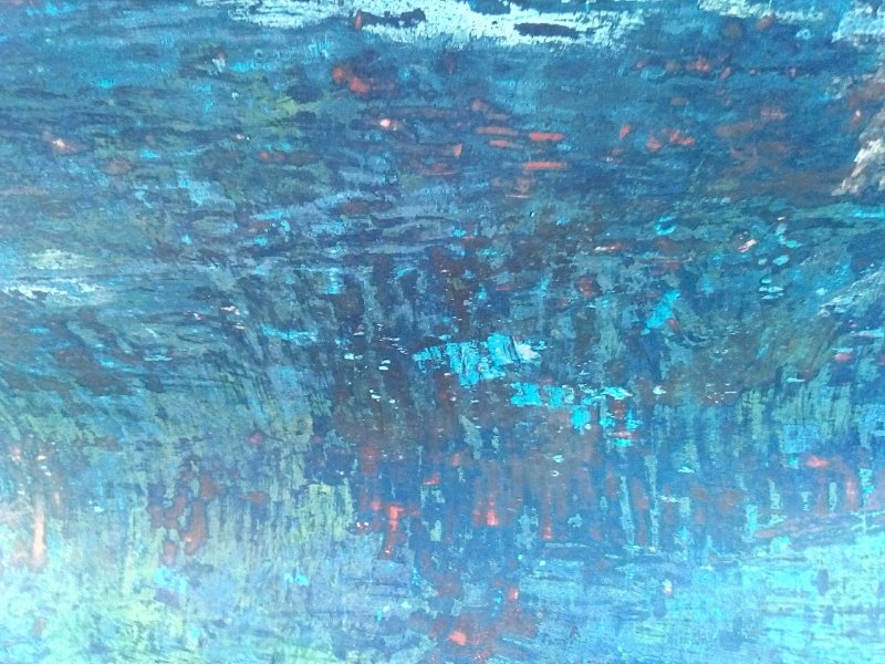

av if1038
19 okt 2018 20:03
Kategori: Common
Tråd: To grind or not to grind?
Svar: 20
Visningar: 44837
I'm started. Today I was scraped all the left board and I wasnt found there any osmosis or blisting. It's great! I think, that "black paint" was exactly that "barrier layer". It have a perfect adhesion to the gelcoat, and it very hard to scrap. In short, I mean, that is not nessesary to totally ...
