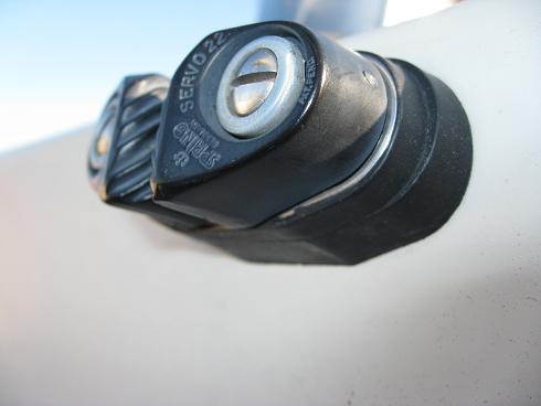

There could be different types as original. Please add a photo.
However, If yours will be the same as mine (and other IF-boats here nearby), the holes will fit Servocleat medium siize ( 8-12 mm) . The scew hole distance is about 40 mm.
I have made an exchange myself on my own boat, as the (white) original old ones began to be poor and did not always keep the sheet fastened. See enclosed picture.
In order to make the angle of the cleat to differ from vertical, I have mounted a wedge underneath. This improves the sheet to stay in the cleat.

- Servocleat spinnwinch_20110605_25_liten.JPG (23.34 KiB) Visad 18762 gånger
- Servocleat spinnwinch_20110605_23_liten.JPG (22.05 KiB) Visad 18762 gånger
