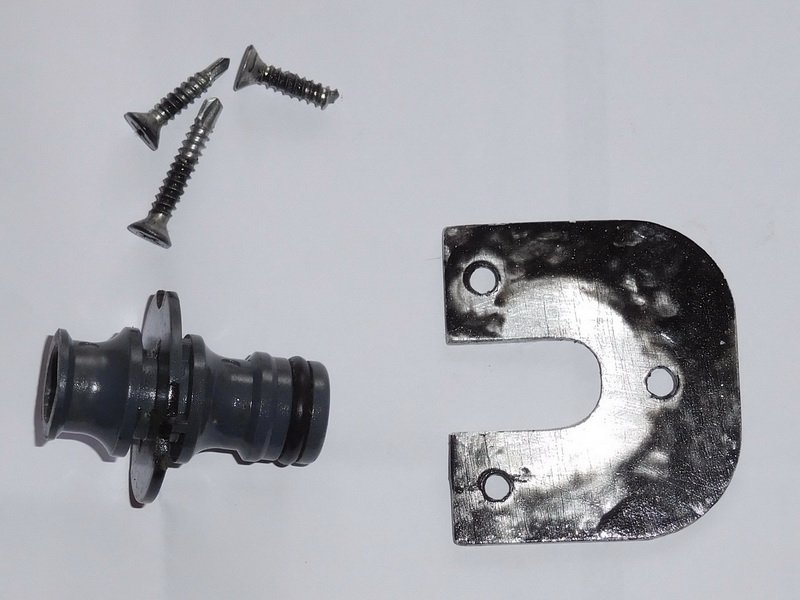

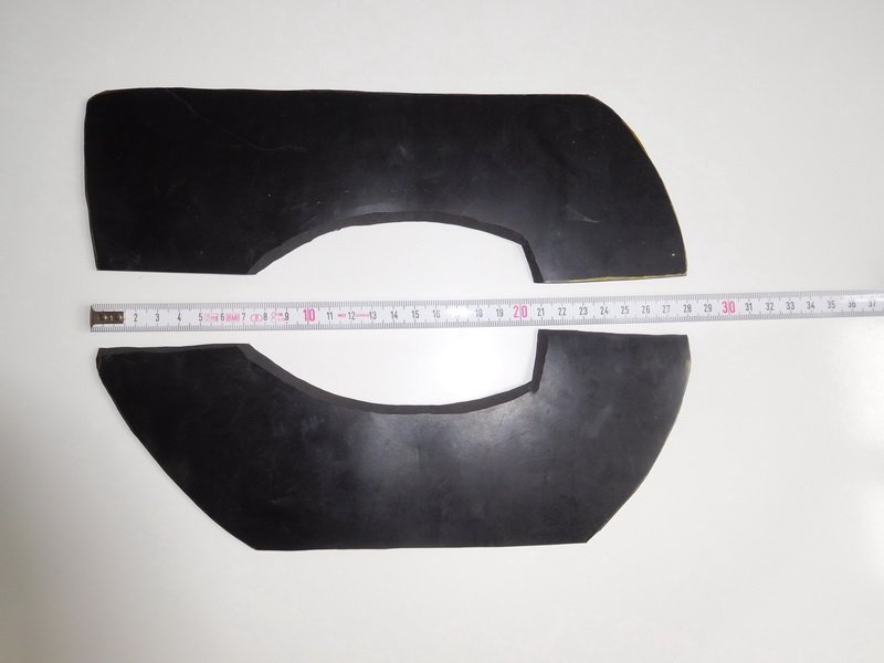

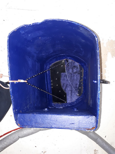

And here the last series
- Water outlet.JPG (126.09 KiB) Visad 8000 gånger
- Rubber lining.JPG (100.57 KiB) Visad 8000 gånger
- Inside the well from above.jpg (94.77 KiB) Visad 8000 gånger
- Inside the well door closed.jpg (97.37 KiB) Visad 8000 gånger
Re: Outboard well
Thank you! Photos are very detailed and it looks like I can manage to do it myself :) Saved to favorites!
