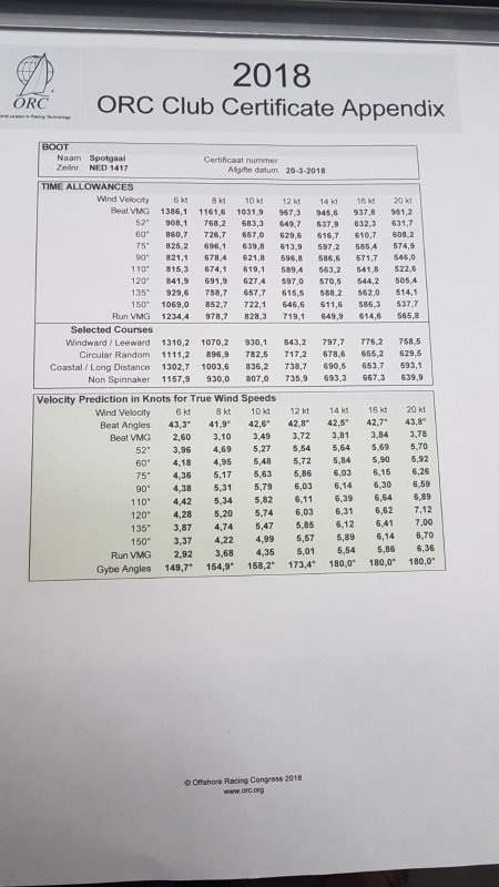

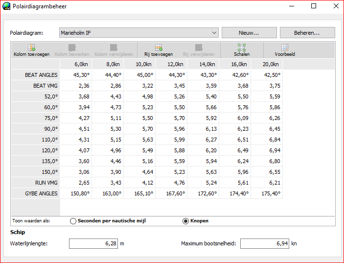

Hi Karin,
Do You mean something like this?
The first one is a part of ORC certificate (not 100% right)
The second one is from an old navigationprogram
[img][
/img]

NED1417 skrev: ↑26 okt 2018 17:13 Hi Karin,
[img][meetbrief.jpg/img]
